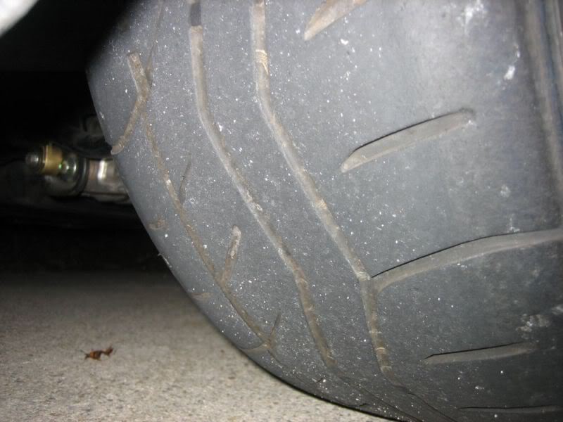

toe off sucks. my rear right wheel was off pretty badly for just a few months, ate my tire up.
hard to tell in the pics but its def. noticable in person. first ones the bad tire, other is the rear left which is still good.
negative camber with correct toe will just eat the inner part of the tire. bad toe with correct camber will eat up all of the tire at a pretty fast rate.
