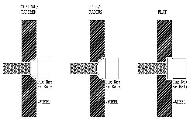

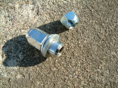

Well, here are two common lug types:
The left is a tuner style or closed end lug, normally for alloy wheels.
The right is a 'lug centric' or acorn lug, normally for steel wheels.
Here's another good drawing:
Even though the lugs thread on and seem to tighten, you need to have the right mating surface.
lol @ nut on the right. We use those dinky little things on the golf carts at work. Good diagram.
Okay. Stock lug nuts are the "acorn" style, rounded ones. No go on those because the rims are tapered for sure. Stuart suggested some Muteki ones on eBay awhile back, so i'll probably look for some of those.
