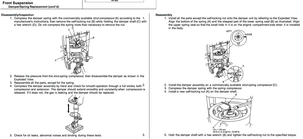

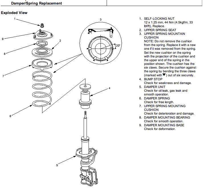

Old Feb 21, 2009 | 09:55 AM
You can get a free rental for the spring compression tool at AutoZone.
