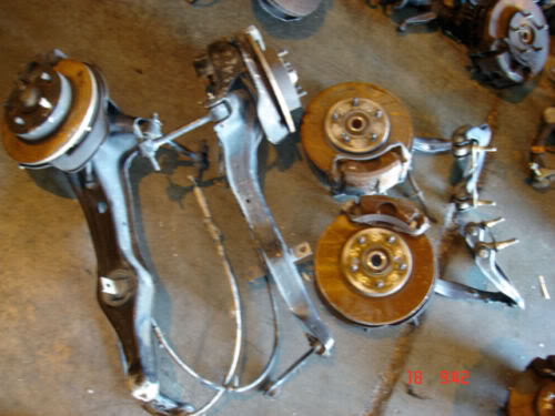

someone gave me a rear trailing arm and disk set up to do a rear disk conversion on my 00 civic hatch dx but im not sure what it came off of and i have heard that the rear trailing arm off a 90-93 integra wont work cause its a different shape so how can i tell what i have? i have looked at the arm and there are no numbers stamped on it or anything, the calipers have the code 7clp138 on them but havent been able to find what year car that is for either, anyone got a simple way to tell them apart and if i can use them, thanks

90-93
94-00:

I can't tell from the pics what one I have, I don't really see anything to tell them apart and the pics are kinda small so they get fuzzy when I zoom in, anythig that I can measure to them them apart?

went ahead and just swaped the spindles and did the swap, turned out to be 90-93 integra parts, asked a friend to look at a parts store to see if the # on the caliper was from what and it was from a 90-93, swap is done and looks great behind my new sparco rims, thanks for the help
