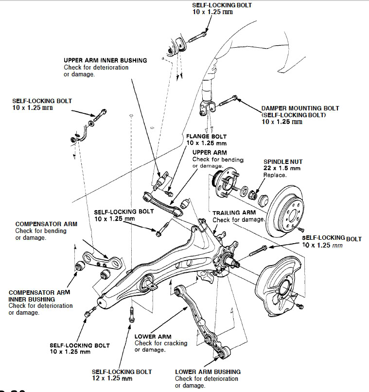

that part that is encircled in the pic need to replace on my civic ut i dont know exactly the name of it?can somebody help me identify it, thanks

If you're gonna replace that you might as well just buy a good rear camber kit. It'll cost you around the same price, unless you get that piece from a junkyard. You typically don't run into that part listed for sale OEM.

I don't think I've ever seen a used UCA for sale lol
