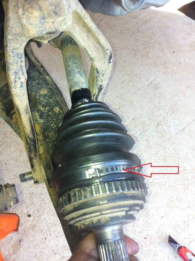

#6: Cut the clamps with a cutting plier, and remove the old boot
#7: At this point i wanted to use a cone tool made specificaly to change this boot, but my boot wouldn´t stretch enough so i did the old way.
