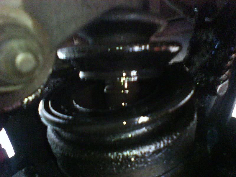

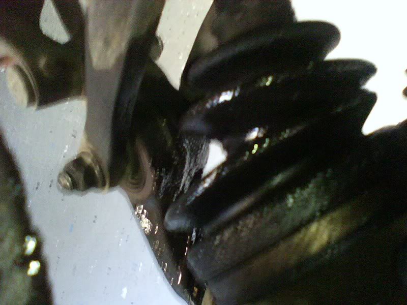

Hey guys and girls.
My axle boot broke and spill grease all over my wheels[:'(]. Anyways, do i just need to replace the boot only or should a just get a new axle? The reason i'm asking is that my car has been making a cluttering sound (ever since i installed my turbo) and i think the sound might be related? However, when i'm inside the car, I pretty sure it's coming from the driver side.. I think... but my axle boot that brooke is the passenger side.
some pics

I looked into this before for someone and alot of people say to replace the axle unless its pretty new. But here is a little write up I had on it from google.
The CV boot protects both the inner and outer portions of the CV joint and keeps away water, pebbles, and other road dirt from entering into and damaging it. The inner CV joint controls changes in suspension and ride height, while the outer one provides even torque transfer. So when the boot is ripped or cracked, the lubricant inside it could spread and mix with the dirt, damage the joint even more, and affect steering and suspension. Damage to the CV boot leads to damage to the CV joint, sooner or later.[/align]It is therefore wise to attend to the littlest sign of defect in the CV boot immediately. Doing so could save you money because the CV joint is much more expensive to replace. You will know that something is wrong with your CV boot when you hear of a clicking sound while your wheels are turning and feel a shudder while you are accelerating or decelerating. Replacement CV boots and joints are readily available in stores and you may want do the job yourself if you want to save money. Some car owners find it more practical to replace their CV axles along with their CV boots. You should consider it, too, after calculating the costs.[/align]

Thanks for the info mill$civic...
I decided to replaced my whole axle instead... it was pretty cheap.. 71 for a new one[8D].
