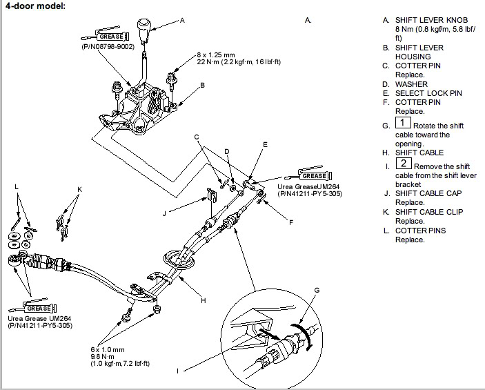

It was suggested to check the bushing in the shifter assembly. Apparently this was easier to do in older modles then the new ones. You have to replace the entire assembly now, not just the bushing. That's what honda told me anyway. They also suggested cheking the cables. I have done lots of searches and can not find any DIY for checking or replacing these cables. i don't know how to get to the cables. It was also suggested that i disconnect the cabels from the assembily. this will help determine where the problem resides.
