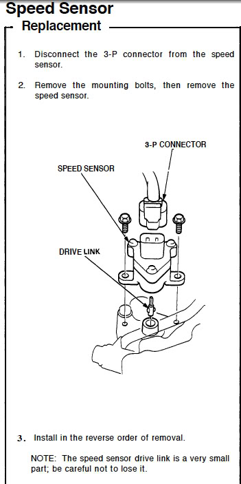

Regarding the speedometer, check whether the vehicle speed sensor (VSS) on top of the transmission is installed correctly:

CEL turns on then off. The seller said that the speedo stopped functioning properly after cleaning the motor so maybe something happened at the VSS, I'll check it out in the morning. Any more thoughts on the trans with no CEL on?

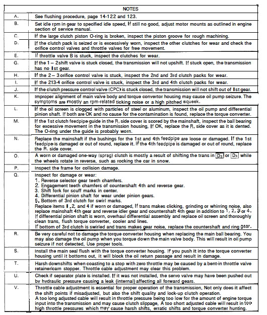

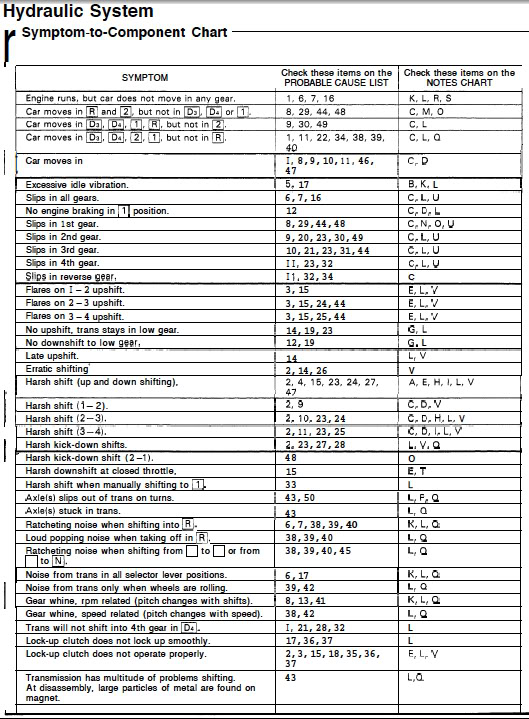

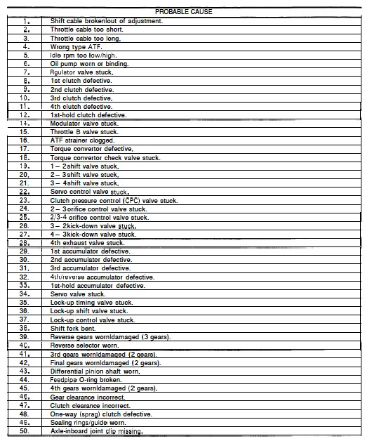

Can you categorize the problem in the chart below?

Hmmmm. Perhaps the modulator valve is sticking when the fluid is cold. I'll see if it does this again tomorrow morning otherwise, if the problem gets worse and rebuild is required, how much do independent shops usually charge for this? I will probably do a fluid/filter change this weekend and use the Honda ATF as a preliminary fix...

...The seller said that the speedo stopped functioning properly after cleaning the motor so maybe something happened at the VSS...
Check the VSS connectors for corrosion or moisture. Clean and blow dry if necessary.

Hmmm...Just had a thought. I wonder whether the potential VSS problem may be the underlying cause or contributing factor for the AT problem you are having. Fix the VSS problem first -- it may help with the AT problem.

I was thinking the same thing, perhaps important info is not getting through. I will do this tomorrow and replace if necessary - keep your fingers crossed for me....
