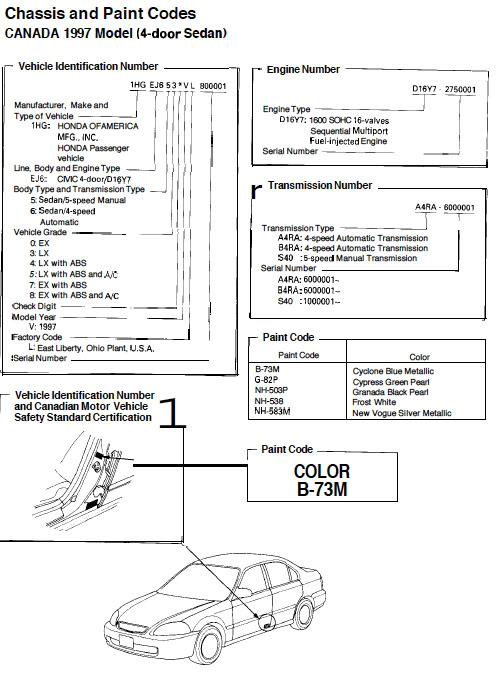

You should be able to figure it out using your VIN and the diagram below.
Is the CEL ON or is the D4 light blinking?

heres what i got. i found i have got the B4RA 4 speed. arn;t they suposed to last for a long while? what is the difference between a cvt and b4ra and will they interchange w. a base model civic lx engine?
