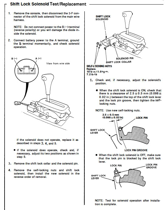

Maybe the Shift Lock Solenoid mechanism is out of adjustment:
