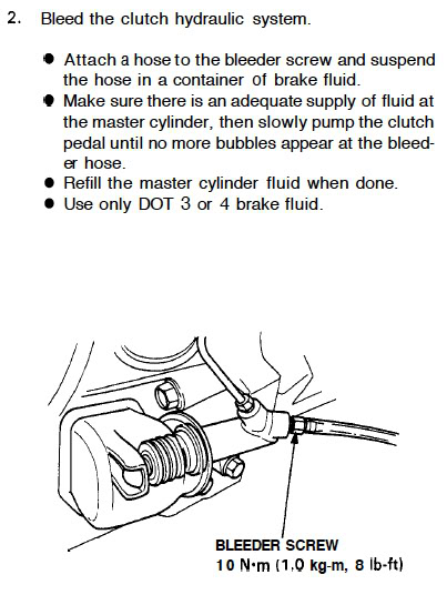

Continue the bleeding process from the slave cylinder until the brake fluid runs clear:

what i would sugest is removing the resevor hose from the master cylinder after sucking out as much fluid from the resevor and remove the hose and rinse the resevor and hose out alittle then pop it back on and refill with new fluid, THEN try bleeding the system out till its clean fluid..
main reason i say that is my old 94civic i just sucked ou tthe fluid and kept bleeding it out but every time i poured more fluid in the resevor it would cloud up a nasty fluid looking crap... but mine had a leak so i didnt bother with it to much because i was gonnna swap it out eventualy but never did.
