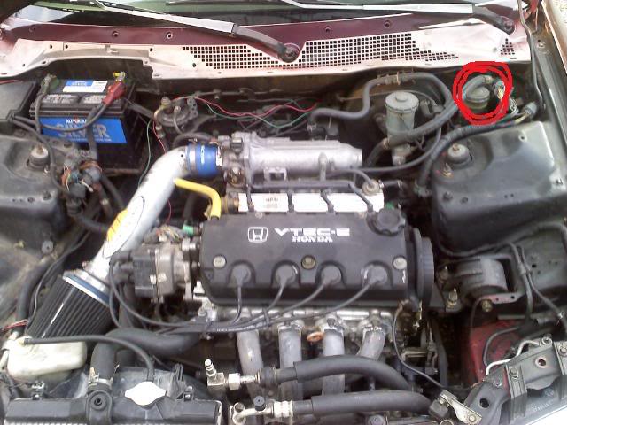

Old Sep 28, 2009 | 12:44 PM
no it takes brake fluid. its right next to the brake fluid canister.
