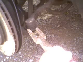

this is what the ball joint seperator looks like

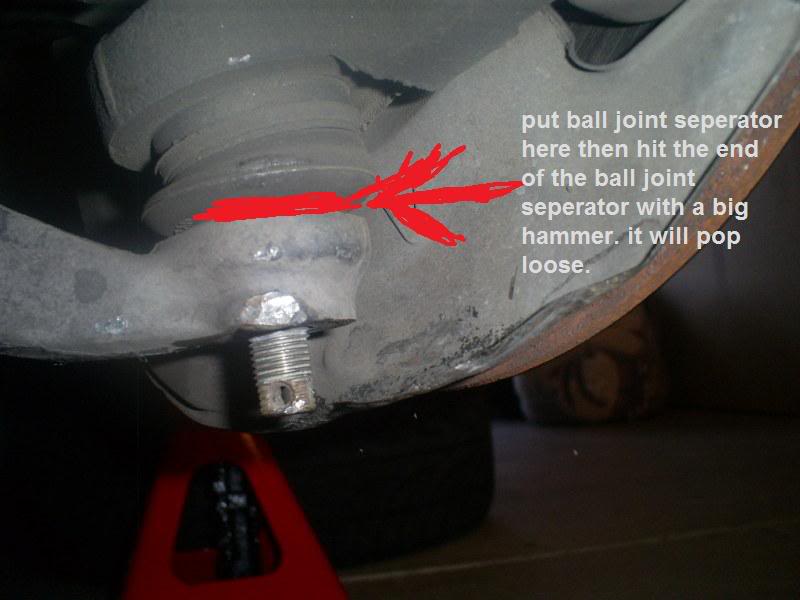

and this is where you put it and hit the end of the ball joint seperator hard with the hammer it will pop loose,
(tip when reinstalling ^ be very careful put the nut back on by hand and make sure you dont cross thread it) its very easy to mess these thread up)

you hit the head of the ball joint seprator like a nail it will pop it loose,
