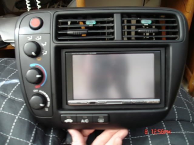

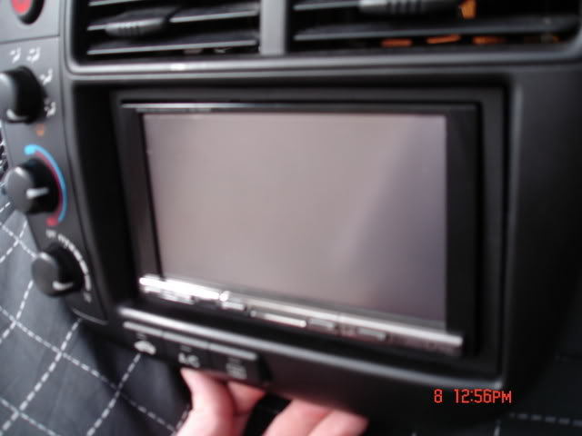

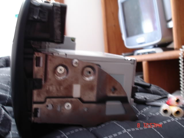

FIRST THING TO DO is tweak the mounting points afew...
put the radio into the center console thing and try to get it to set close to flush.... you will need to grind some metal or drill new holes to mount the radio more flush... cause with it just screwed in using the factory mounting holes it will sit back and PERSONALY to me it just doesnt look as good... i also tilted my radio abit because the way it sits with the factory holes just seems to TILTED BACKWARDS for me... and im 6ft tall, with it also tilted down more it makes the picture look beter just cause of the viewing angle you see it from.
pics of mine
its tweaked outwards just alittle bit but i would like to see it more flush but to lazy to pull it and tweak the mounting holes on the stock brackets..

its not tweaked much BUT it doesnt take much to look beter..
second thing to do is attach the radio into your center dash console, with the set screws included with the radio, they should screw right in thier...
now its time to GUESS how HIGH/low you need that bezel to be to clear the top and bottom to clear the console.....
