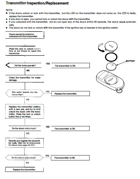

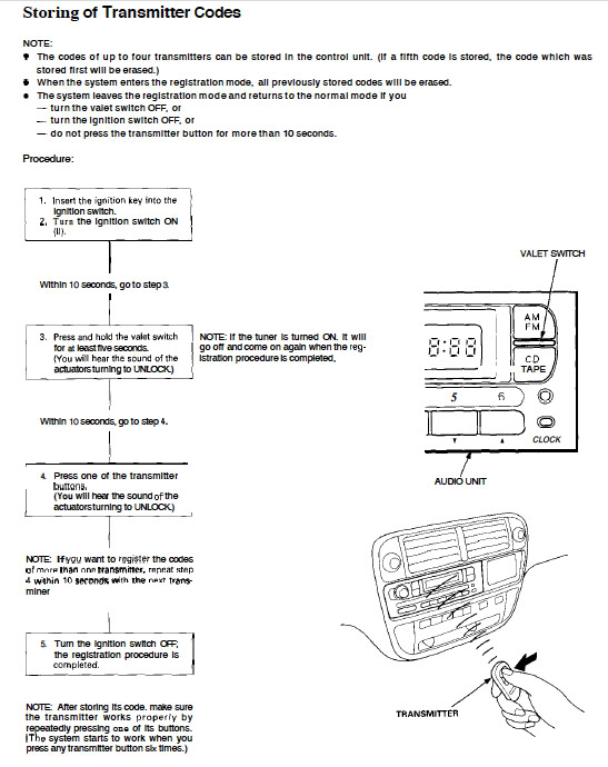

1) Is the battery in the transmitter fresh and was the transmitter properly activated when the battery was replaced (see pictures below).

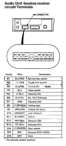

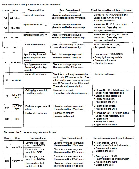

2) If you rule out the transmitter (essential for next step), then do the keyless receiver control unit input test described in additional pictures below. You will need a multimeter. This test will localize the problem to a specific component versus the control unit itself.

I reprogrammed it using the instructions from the Honda Service Manual, and now it works great! I did have to actually hold down the valet switch while I pushed the button on the transmitter (the manual makes it seem like the valet switch is released once the actuators click). The passenger side door still doesn't activate the dome light, but I think maybe I never noticed that before because thedome light comes on when the doors are unlocked via the transmitter. So, that must be a completely separate problem that just seemed to occur at the same time that the transmitter stopped working. It's kinda weird that it quit working when it did, because I didn't change the CR2025 battery or anything (until yesterday, anyway).
