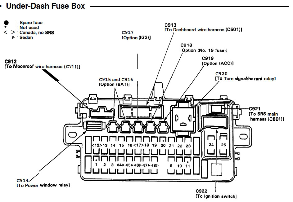

Bought a new main relay and it didn't fix the problem. I checked all my fuses and found a blown 15A under the dash. Tried changing it 3 times and it blew each time when I put the ignition to the on switch.
Heres a diagram to show you which fuse. It is the 15A on the top row closest to the left with the exclamation mark.

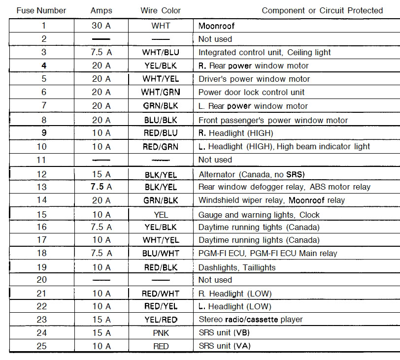

Which specific fuse is blowing?

Fuse 12 is the one that keeps blowing.
Also fuse 15 and 19 are using 15A fuses but your diagram says they should be 10A?

Also all my fuses on the bottom row are different amps than your diagram. and your diagram says fuse 2, 11, and 20 aren't used but they have fuses under my dash in those spots.
Install the properly rated fuses as indicated in the diagram. Regarding fuses 2, 11, 20, did a previous owner install aftermarket electrical components (e.g., an alarm system that needed those extra slots)? Alternatively, extra fuses have been inserted into those slots.
