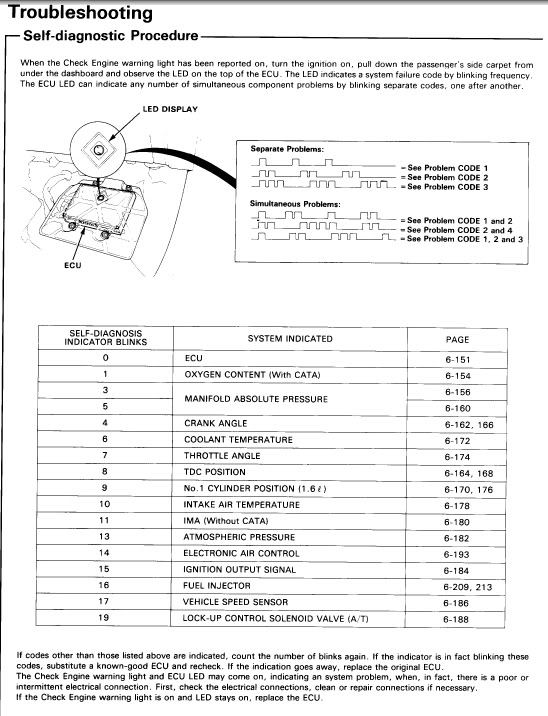

Start by determining the CEL code that is blinking from the ECU LED (see diagram below). Post the code for feedback.

the ecu is flashing 7, 16, & 17. I down loaded the 88 civic manual from "http://hondatech.info/downloads/Auto/Manuals/Civic/" so i can see what my next step is.
