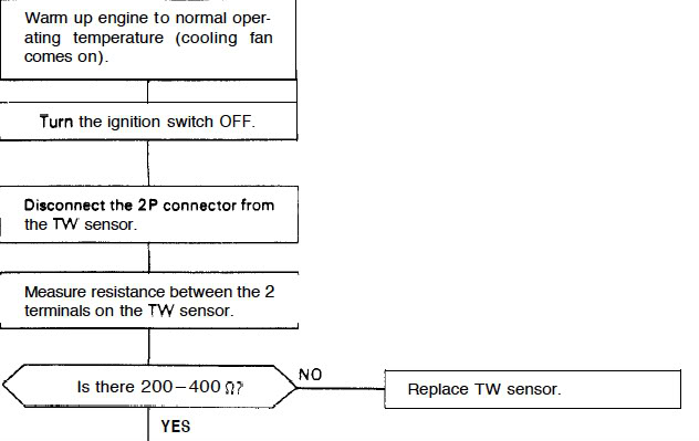

Test the 2-wire coolant temperature (TW) sensor located below the distributor as detailed in the diagram below.

How do I measure the resistance? Is this the sensor on the thermostat that turns my fan on? If it is that sensor, it works because it never used to turn the fan on and i replaced it and the fan comes on fine now.
You use a multimeter. Resistance is measured in Ohm units.
Is this the sensor on the thermostat that turns my fan on? If it is that sensor, it works because it never used to turn the fan on and i replaced it and the fan comes on fine now. Or are they two different things?
The fan switch on the thermostat housing is different from the 2-wire TW sensor just below the distributor.

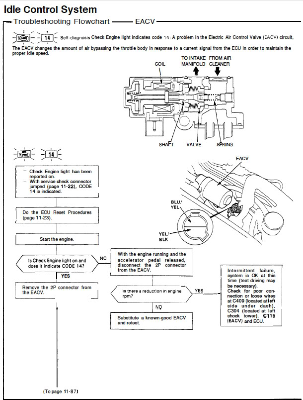

Im so glad my check engine light finally came on today. Code 14
Checked it out and it is the 14 IAC (EACV) - idle air control valve
Going to replace it with a used one and clean it out with carb cleaner and see if it works

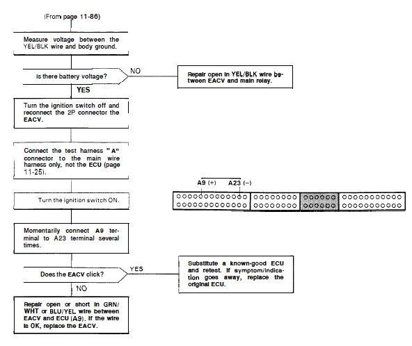

Troubleshoot the circuit before you replace the EACV:

I need to buy a multimeter. Thanks RonJ
