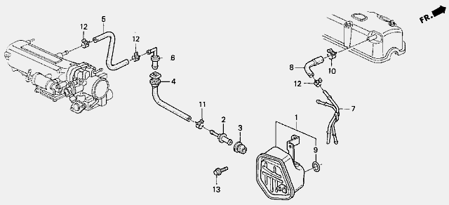

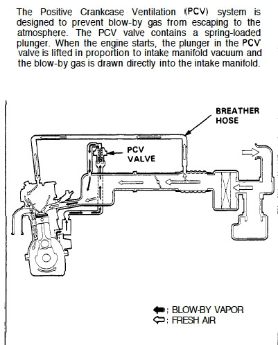

Originally Posted by bcrichguitars
I'm just worried because I think the piece of the PCV that broke is sitting in the intake manifold still. I dont know how I'm going to get it through the oil breather chamber. How will I get it out if I dont see it in the breather chamber?
Edit: I made a potentially important discovery. The PCV valve of 5th generation Civics is apparently inserted between two PCV hoses rather than into the breather chamber (see diagrams below - PCV valve is part #6). If your JDM engine is the same, then the valve piece may simply have fallen between the intake manifold and block outside of the engine. It also may be still attached to the second PCV hose. This should simply the fix as you won't have to remove the breather chamber because valve piece is not inside the chamber.

Old Mar 10, 2009 | 06:37 AM
  #87
I dont understand, the PCV wasn't hooked on to anything it was in the rubber bushing in the intake manifold. This confuses me even more.
It didnt have a vacuum line on the other side. How can I get this out? Does this mean I need to remove the intake manifold?
Your top photo shows the other end of the PCV hose attached to the IM. In the middle photo, it doesn't make sense that the PCV valve would also be inserted into the IM.
Is the JDM engine so different from the USDM? You should now carefully inspect the vacuum hose routing on your engine.

I feel like an idiot working on my car last night in the dark! Today I looked at it and seen that the hole the PCV valve was in doesn't even go into the engine! What a stupid mistake. I'm going to jack the car up and take a closer look at what the PCV valve is supposed to have underneith it. I dont think I have parts 11, 2, or 3 in your picture that come after the PCV valve. I'll update.
Old Mar 10, 2009 | 02:09 PM
  #89
bcrichguitars's Avatar
Posts: 677
Ok so I found the found where it is broken part number 4 is stuck in the hose. I'm going to try and get it out from underneith and get a new PCV in there.
Good, that should be a much easier fix than you thought last night. I hope you have regained some renewed enthusiasm for working on your car again.
