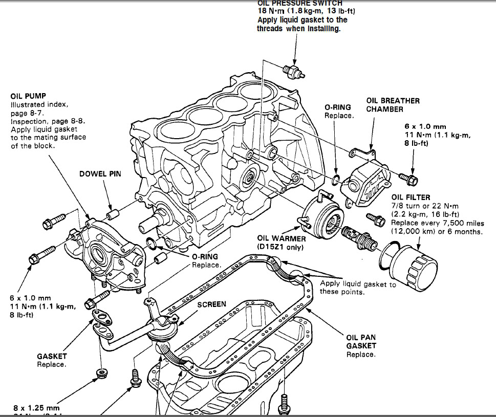

The fact that the piece was large may prevent it from moving out of the oil breather chamber into the crankcase. Nonetheless, I understand your concern. You'll need to remove the breather chamber to extract the broken piece. See diagram below. It's probably accessed from below like when you replace the oil filter. Removal of the oil filter may help.

Thank you so much for your help I'll do it first thing tomorrow after school. So the hole where the pcv valve is on the intake manifold goes directly to the oil breather chamber?

...So the hole where the pcv valve is on the intake manifold goes directly to the oil breather chamber?
Middle picture: The hole where the PCV valve inserts is in the breather chamber.
Top picture: The other end of the hose attached to the PCV valve connects to the nozzle on the intake manifold.
