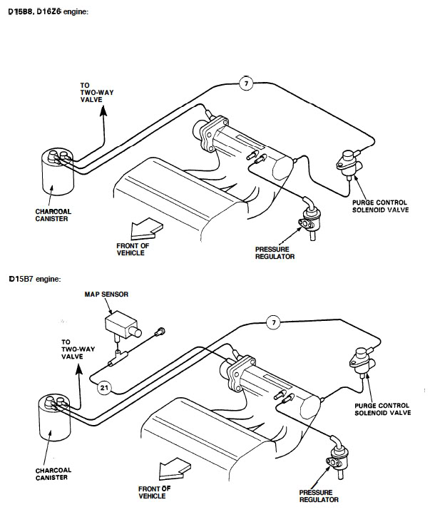

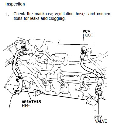

Do you have the D15B7 or D15B8 engine?
The top picture shows where the PCV hose should connect to the intake manifold. The adjacent vacuum hose should lead to the fuel pressure regulator.
The middle picture shows where the PCV valve should be inserted into a rubber grommet.
I am not sure what I am looking at in the bottom picture. Is it the purge control solenoid valve? Can you post a picture that pans back to show more of the engine bay.

The bottom picture is the charcoal canister I believe, in the top left of the engine bay. It says PCV on it. It's a D15B.
The middle picture isn't a rubber gromet though it broke off the pcv valve. Its plastic, how do I remove it?
