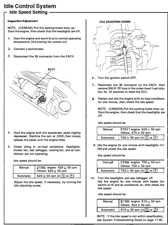

Below is the proper procedure for setting the idle speed. You need a good tachometer to do this properly.
If the fast idle port sucks any air when the engine is warm, then the FITV is dirty or needs to be replaced.
