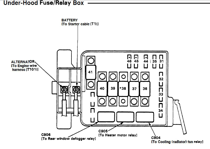

i dont think so. dose the alternator run off the big fuse?
Old Jan 24, 2009 | 04:08 PM
  #32
Did you check the under-hood fuses I mentioned?
Old Jan 24, 2009 | 04:10 PM
  #33
2fastcivic94's Avatar
Joined: Sep 2008
Posts: 79
From: Lewiscenter,OH
no i didnt check all of them.
Old Jan 24, 2009 | 04:15 PM
  #34
Check whether fuse 41 (80A) or 39 (50A) under the hood is blown.

ok i check the cable that runs to the alternator and no power going to it.

You dont need the alternator for the car to start up so if thats your problem check all the connections from the battery terminal to the fusebox to the starter and then check the fuses
Old Jan 26, 2009 | 12:34 PM
  #39
If either fuse 39 or 41 are blown (which seems likely), the engine won't be able to start. This should be checked first.

that fix the problem. number 41 fuse blew.. thanks guys for your help!!!
