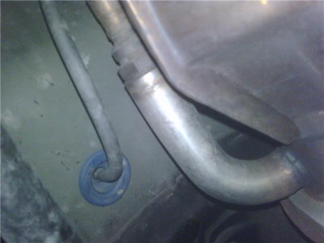

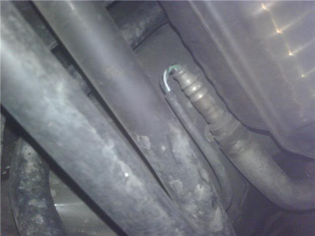

-replaced primary O2 sensor
-replaced cat with another specific for my car lol
-washed and waxed
I originally ordered a magnaflow high flow cat, installed it, later on it threw a check engine light. CEL said Cat was bad, I'm like no way. So I think maybe the cat/secondary O2 sensor is going bad, but it's not telling me yet. I replace that, CEL still on after reset.
So I look online again for a magnaflow cat for my civic and it pulls up a different model # than the one I have. I call them up, ask them what year civic is my cat for, they say 96-98(at the time they said 96-00) and that I need one for a 99-00.
When I originally put it on I noticed the O2 sensor sits on the pipe after the cat, but the OEM cat has the sensor hole in the middle of the cat.
So I ordered the new CORRECT cat, matches the OEM and has it's own heat shield already mounted. It even looks like better quality than the one for the 96-98 even though they're both magnaflow.
BTW anti-seize is the best thing anyone could buy, no more penetrating oil and hammer to remove stuck bolts
Even though the O2 sensors were never bad, I went ahead and replaced both because they each had 155k on them and sooner or later they'd go bad. Autozone wanted $195 each for primary and secondary bosch sensors. I got the same one's on amazon for about $80-$90 each.
Next on to-do list: replace headliner and sunroof cover, put some foam padding in all armrests, replace rear blown speakers...again...wtf is my problem with these?!?!?!
Now that my cel is gone, time for 1 month overdue inspection.

ok thanks, but my problem was the wrong cat was installed.
what I have now, correct version:
http://www.car-sound.com/02product/d...irectfit=22630
What I had before today:
http://www.car-sound.com/02product/d...irectfit=22628
See the O2 sensor placement. And why can't I post pics anymore?
