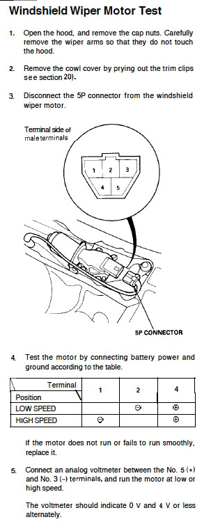

hey guys am having some issue with my wiper on high it bearly wipes can someone help
