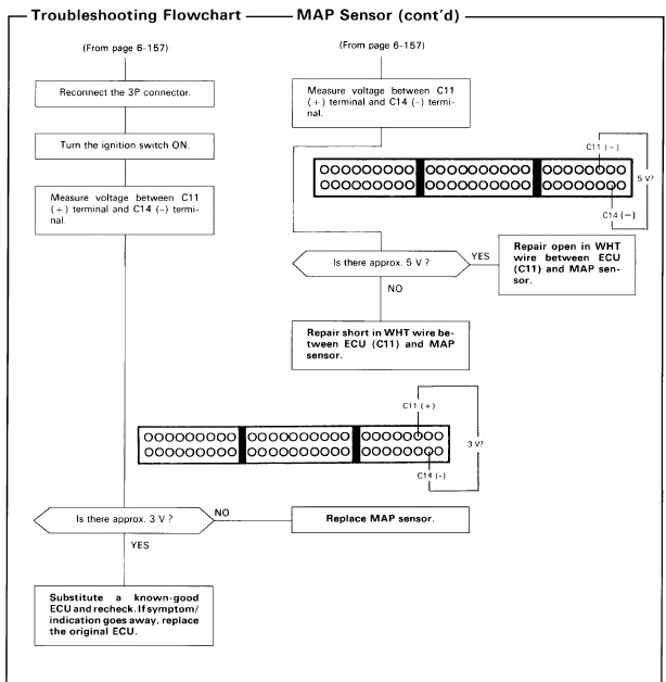

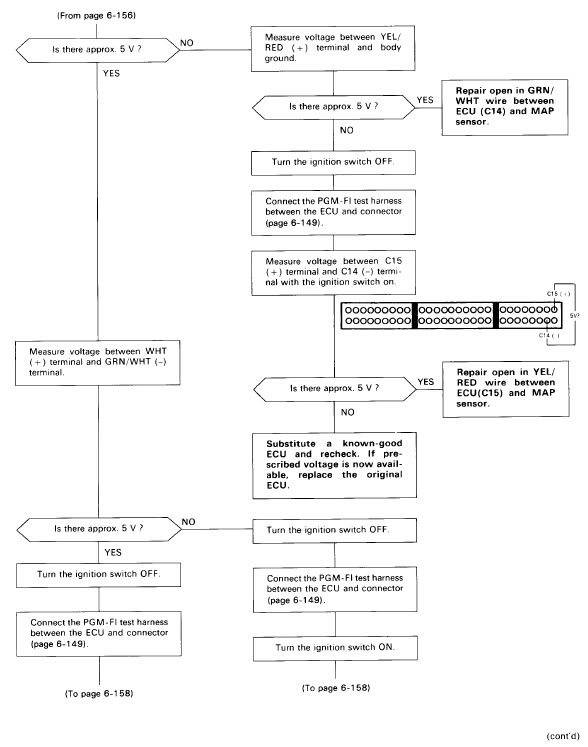

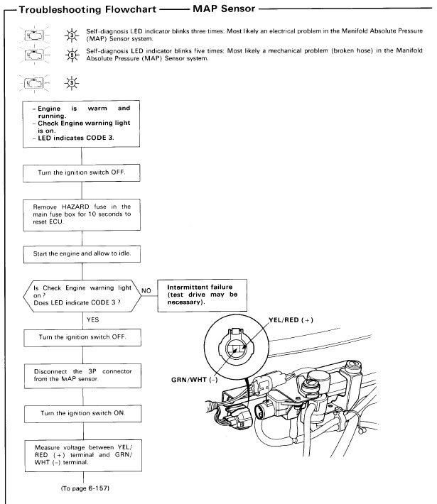

I think you have found the problem. Codes 3 and 5 indicate a problem not with the IACV but with the MAP sensor or its circuit. The three diagrams below tell you how to troubleshoot code 3:

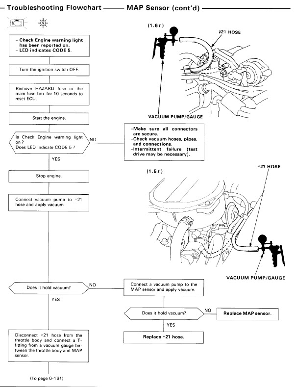

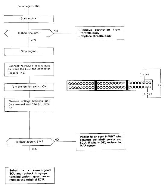

Here's how to troubleshoot code 5:
