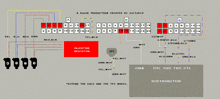

yes the dohc zc head is the ONLY head that will fit on a sohc block
for the si gauge it just plugs rite up, no extra wiring needed. the tach will work
for the coverting from 2 fuel injectors (dpfi) to the 4 fuel injector system (mpfi) is a big gain you will like it.
i have done it.
