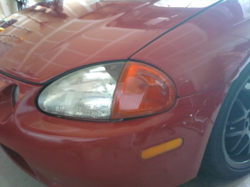

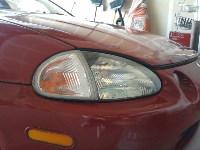

This is what my Headlights looked like after a DIY black housing and Stock colored corners..

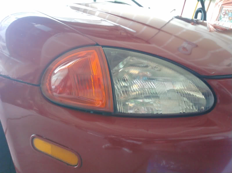

And this is what it looked like after I did my own amber corner lights

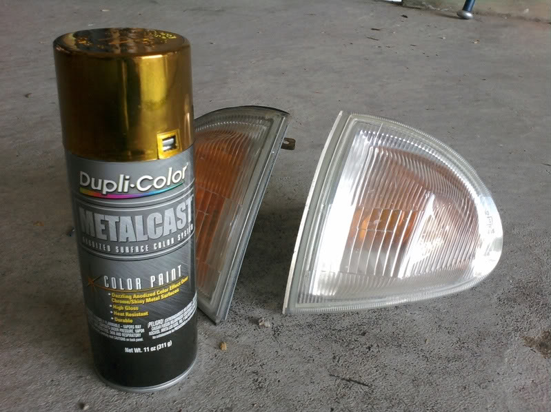

All you need is:
A spray can of "DupliColor Metalcast" in orange. ( got mine for $7 bucks)
your OEM corner lights. (or w/e you have..lol)
Clear coat (if you want. I didnt use any)
And soap and a towel to clean your headlights before spraying them.

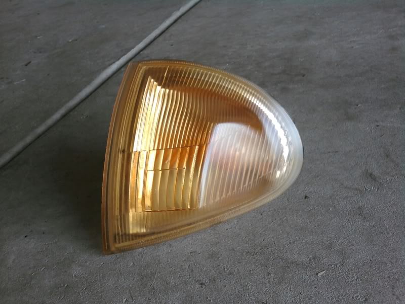

This was my first coat:

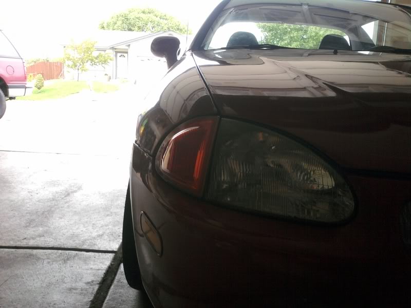

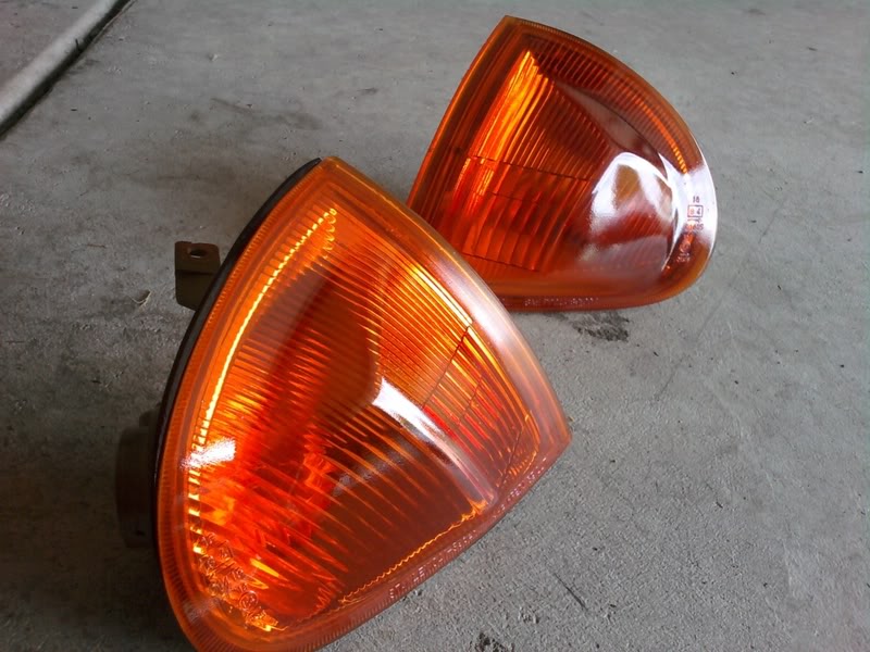

And this is what it looks like after
5. And i guess you can clear coat them for them to last longer. I might be doing this tomorrow since Im happy with the way they came out.
BTW While the paint is drying the paint might seem a bit dull, But once its completely dry it will turn nice and glossy.
IMO it was WELL WORTH the $7 I spent on the Spray Paint.
Im very happy with the results.
