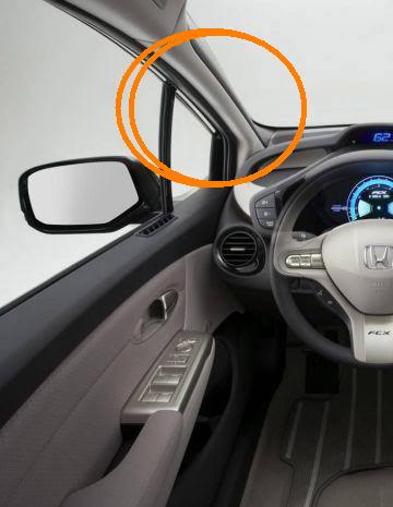

I need help taking this off
I drive a 95 civic anyone know?

I mean i know it can be pulled off but i dont want to break the clips

nvm im using a flat head to carefully take the clips out
Old Aug 24, 2010 | 10:58 AM
With the A pillar, you just pull it. Start from the back of the door area and work your way forward. The clips wont break. They're metal on plastic. Worst case, they slip off and you clip them back on.

But yea, just carefully pull on it. The clips on the back of it just snap in and out of place.

thank you yeah i saw they were metal after i got the first few off i just didnt want to brake one
