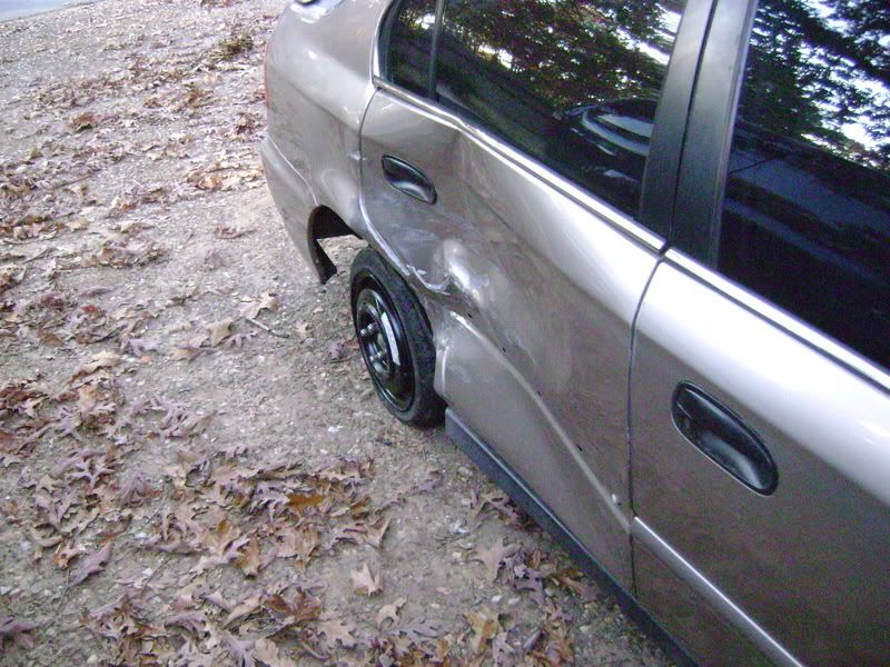

Here it is..I'm still debating whether it's worth $1450. I have only deposited $100 to the seller (but he is leaving the country within the week, so I don't want to screw him over by backing out).
Take a look at the rear quarter panel (in front of the rear wheel) on the passenger side. That's what worries me the most..

One tire "drastically" worn suggests the frame may be out of line and that wheel is not aligned straight (and perhaps never will be). I suggest taking it to an alignment rack and having it checked. The quarter panel is just cosmetic though.

It looked like an alignment-type wear...one side was worn and there was the small bubble. He had the paper showing that it had been aligned, but I didn't scrutinize it very thoroughly. If this paper shows that it was able to be aligned, then it would be good to go, right? Or am I missing something?
Old Aug 29, 2012 | 05:19 PM
The paper shows the alignment results. It's not guaranteed that it's perfectly in spec.
If it's the right rear tire that's doing that, I can tell you it's permanent body damage causing the uneven wear. It'll continue to to do that unless you get aftermarket adjustable alignment components for that side.

Eww, that does suck. The uneven wear was on the front left tire. He says it shakes at speeds of 70mph (hopefully due to the bulge). The rear right tire had recently been replaced.. Which makes me wonder..... why?
