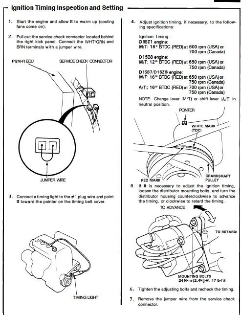

Do a general tune up, including checking the ignition timing. If any codes are pulled, then reset ECU and drive car to see if the codes repeat.

whats best way to check ignition timing?
Old Mar 10, 2010 | 02:03 PM
AutoZone won't pull OBDI codes. Use the jumper wire method - click CEL link in my signature. Does the CEL work?
