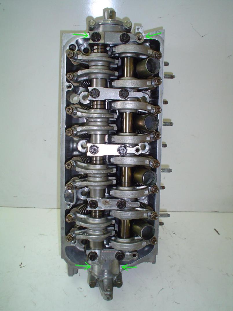

Im not 100% sure but i think it goes in the 4 corners on the side of the cam.
Here is a pic.

Ill try again

You put the new rubber seal onto the valve cover. Then you use the liquid stuff on the corners of the rubber where it begins to loop upward over the camshaft. Its just the 4 corners of those arch things. Then you put the whole thing carefully back down level onto the head and torque the bolts down to spec.
The liquid stuff ends up between the head and the new gasket on the cover.

Put just a tiny bit on the corners, or you'll have a mess that will be hard to take apart next time. While you have the cover off it's a good time to check / adjust the valve clearance if that hasn't been done recently.
