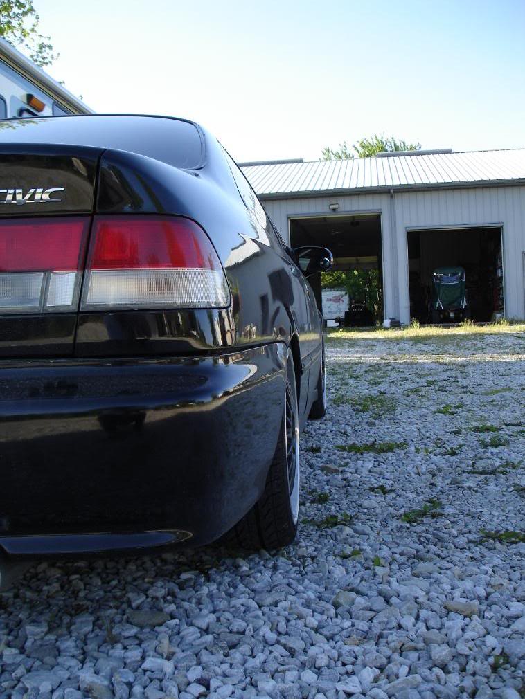

if ya ever want to lower the car a bit the 43offset will make it even easier to lower...
unless you like the wheels sticking out a bit....
35s will be almost even with the outter fenders or out just a bit and rub like a ****
and the 43s will tuck in nicely.. those are what i would buy for a 7inch wide rim! these are mine which i believe are 42offset

go with the 43offset...
heres a quick refernce best pics i can find..
old rims i believe 36 or 38offset. they where about even with the fenders which was very bad for lowering and rubbing!!!!

my polished lip/ gunmetal rims are 42offset.
