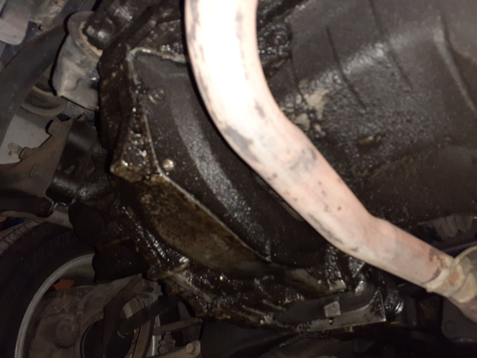

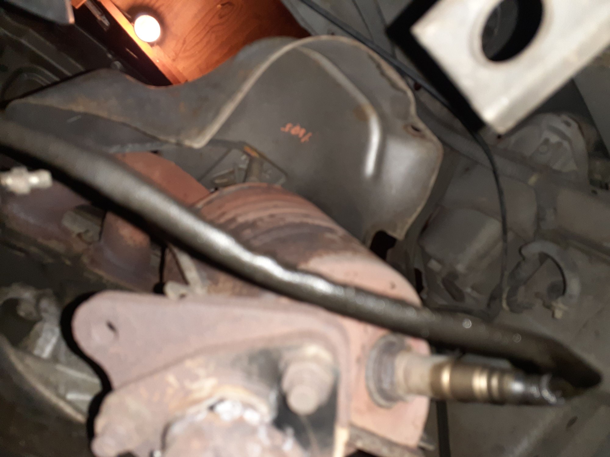

My bi-annual Smog check (CA) is coming up next month, OCT 2020, and as luck would have it my CEL came on a month ago. ODB Scanner points to the O2 sensors, or Catalytic Converter (p0420).
If I took care of all that I needed to to pass smog I ALSO need new tie rods, rack and pinion, control arm, alignment and new brakes that was quoted to me for $950. I paid $1600 for the car 14 months ago. Is it time for me to move on and stop pouring money into a car with 273,000 Miles??
Also, a oil leak I cant find.
Oil leak
One of two ball joints.
Downstream o2 sensor and cat converter with what looks like a weld not normally needed on this model.

get a quote from another shop price seems kinda high and that many steering suspension problems with the vehicle your either terrible at maintaining your car or the shop is trying to soak you for money. also o2 sensor codes dont necessarily mean a new cat and sensor it could easily be something stupid and cheap to fix. im always su****ious when a shop tells me everything dealing with the steering and suspension in the front is shot but the car runs fine. i can see 1 part here or there being questionable and not noticing but when basically they are telling you the whole front end is bad something is up.

pff order those parts yourself and you will cut the price by half or better. the lower control arms he has on the list are mevotech. he has them listed at 129 i can have them delivered for like 50 bucks.
www.rockauto.com
Old Sep 27, 2020 | 07:00 AM
drakon543's Avatar
Joined: Aug 2019
Posts: 192
with shipping straight to my house its only 147. significantly less than his parts price.
Old Sep 27, 2020 | 07:05 AM
drakon543's Avatar
Joined: Aug 2019
Posts: 192
116 shipped if you wanted to go with cheaper lowers.
