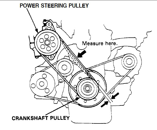

i jus checkd the fluid its good. how would i check the belt like i have no clue which one it is

Default RE: weird steering noise
Old Jun 1, 2008 | 06:54 PM

ok i touched that and its not loose loose but its not tight

You might want to try tightening the PS belt or replacing it. If this doesn't help, then your PS pump may be bad.
