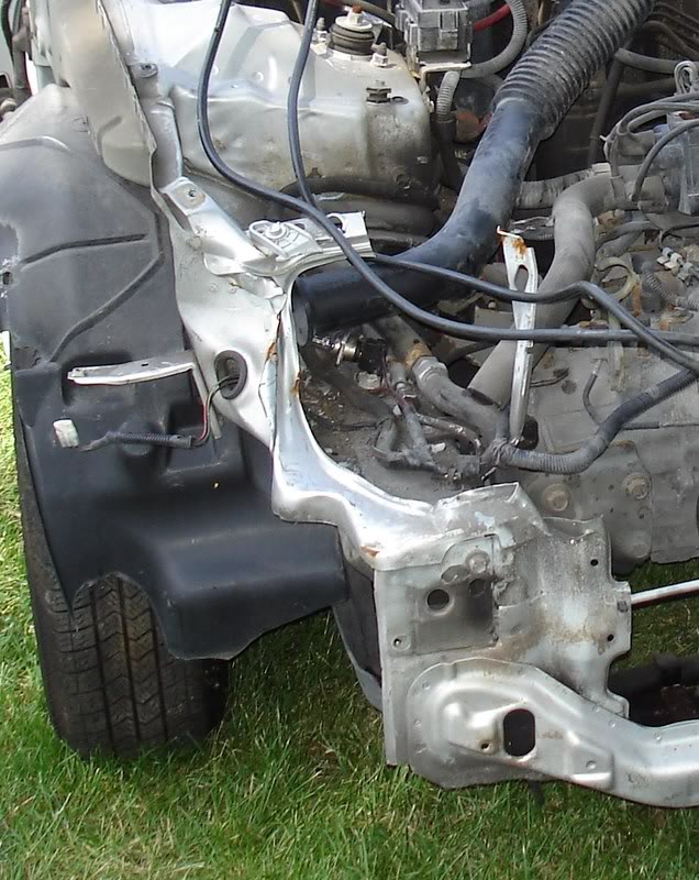

Default RE: my soon to be addition. another civic
ya the only damage i really have to straighten out is the passenger side inner fender ontop. other than that everything looks good and straight.
good side.

bad side

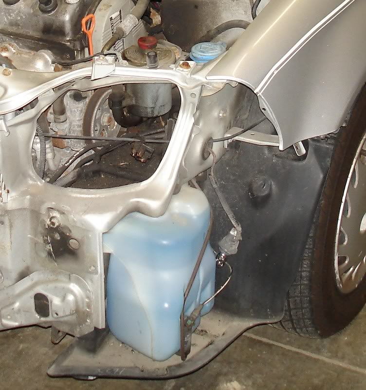

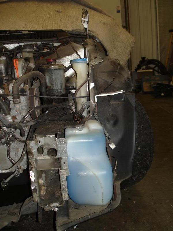

just noticed something... front end took a beating, took out your radiator support, etc. but the windshield washer fluid bottle - still entact. LOL
ya i thought about that to.LOL and i must say WOW suprisingly i already got my new radiator support in the mail today. so im gonna go eat something and then start working on cuting the old one out.

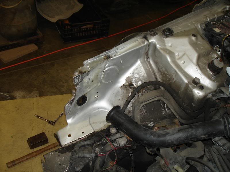

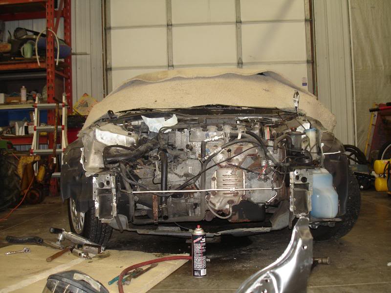

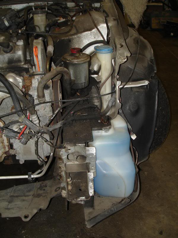

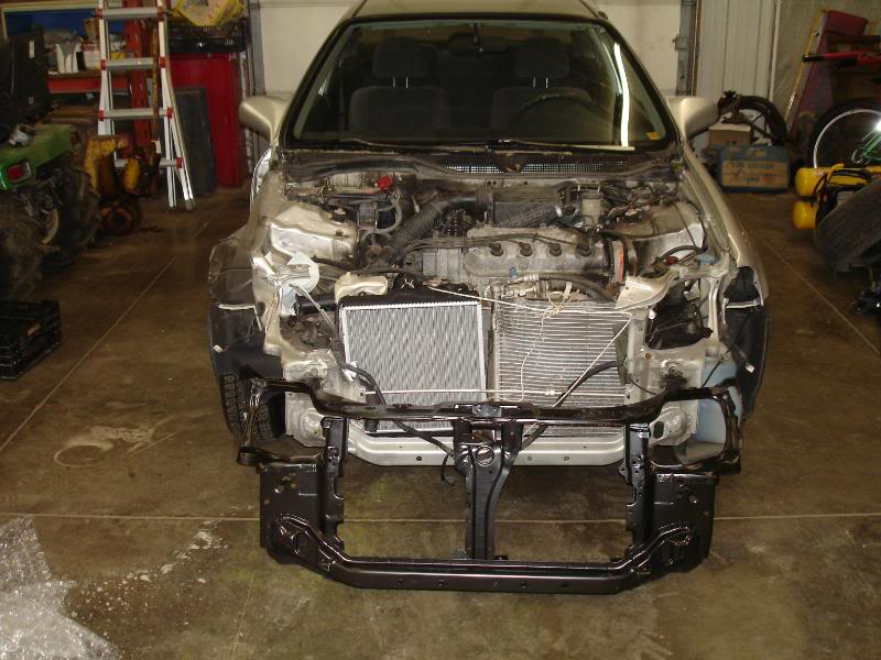

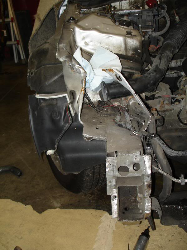

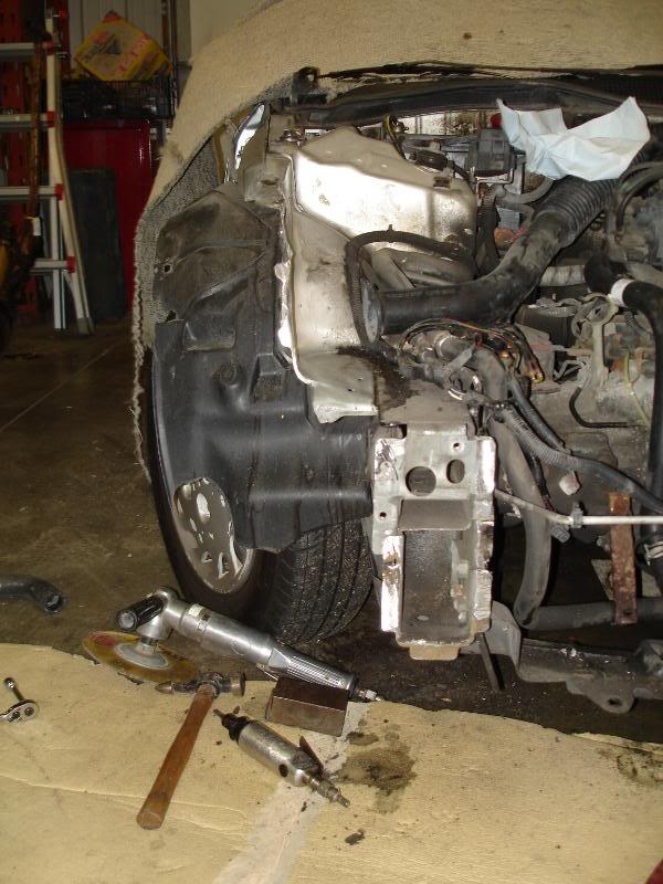

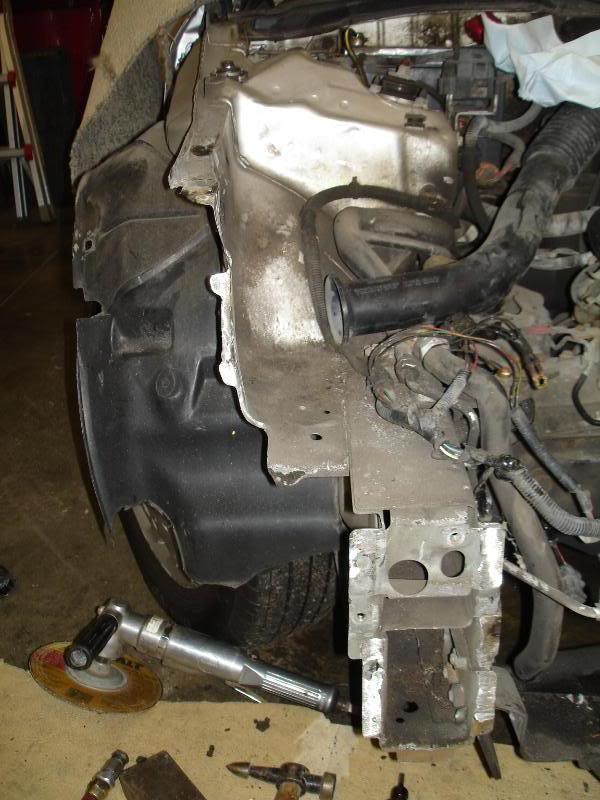

Default another project civic 96DX repair pics Pg 4, 7-29-08
so far so good!
i got whats left of the support cut out, all straightened out. tomorrow im gonna was the whole engine bay, primer the grinded/hammered metal all out spray some silver paint on the spots i probably cannt get to later on.
Air chisel and Hammer and dolly FTW..... [8D]

BEFORE

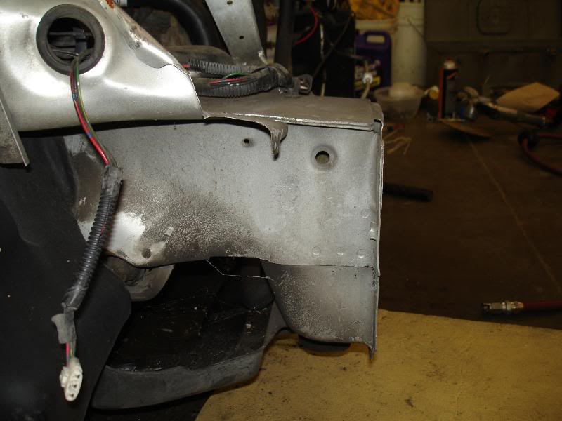

and mostly after.

ugly @ss DX header.LOL

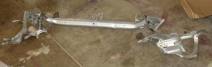

and the rest of the scrap metal i cut out

gotta try to get some weld thru primer tomorrow and some silver paint. and tomorrow ill drill holes thru the new radiator support and weld it and smooth the welds over and paint over them for a original look.
so far its all good! the AC maybe the biggest PITA since its so tight i might have to pull the header to install the new condenser later on!
