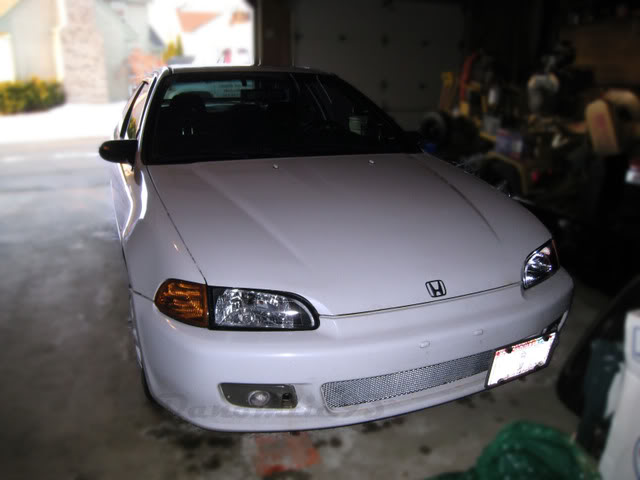

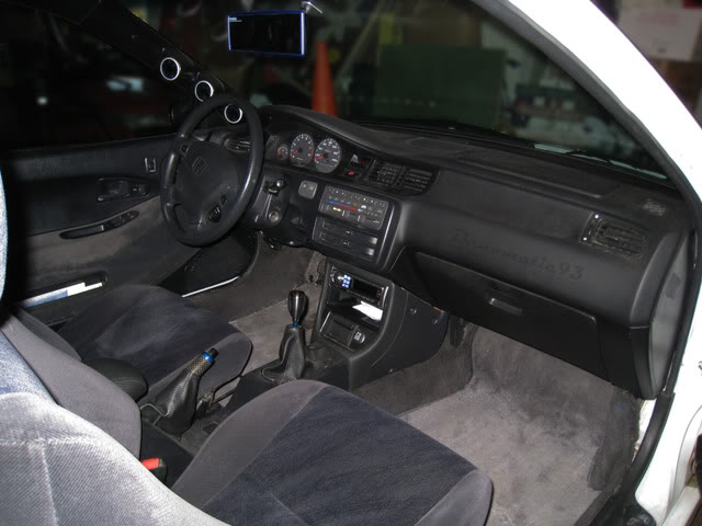

I have a mini-update...
It's the middle of winter but I gave my baby a car wash

whoa did I miss something when did you revert from the projectors back to stock?
Old Feb 1, 2009 | 05:13 PM
  #136
danomatic93's Avatar
June 2010 ROTM
Posts: 3,284
From: Milwaukee, WI
lol, right before winter started. BUT, they're not stock, they're JDM styled blacked out housings with city lights.
I was disappointed in the overall light output with the HID projectors in the stock housings. I think that the OEM glass' rippled surface scattered the light all over. Oh well.

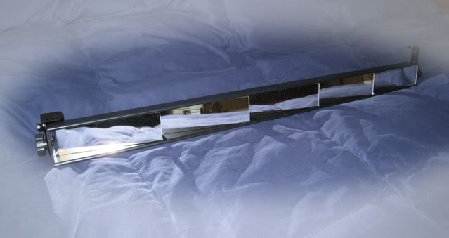

Iv seen that rear view mirror in some civic's that went from the pass side to the drivers side, how long is that thing?
Old Feb 3, 2009 | 01:27 AM
  #139
June 2010 ROTM
Posts: 3,284
From: Milwaukee, WI
It's just 2 inches shy of 3 feet. I can't wait to install it. I'll remove the stock mirror for the windshield and the sun visors as well. Then attach the brackets to where the sun visors once were attached.

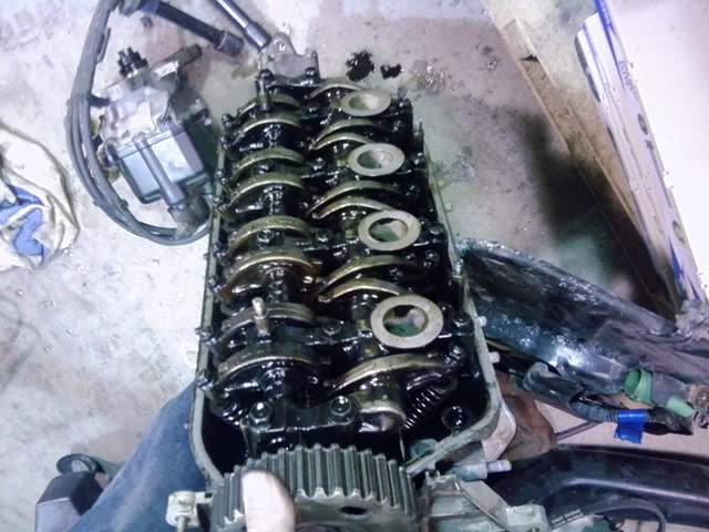

Mini-Me-Mini-Side-Project-Build
Also, I've been helping a good friend of mine with a mini-me swap. He has a 90 CRX Si. He had a bad head gasket for a good 6-7 months now, but it finally got pissed. So, since I conveniently convinced him last summer to buy parts for a mini-me swap, he had everything ready to go.
He's going with the Z6 head, while retaining the stock D16A6 block, intake mani, dizzy, exhaust, and computer. We're keeping it OBD0 for cost and simplicity reasons.
Yesterday Afternoon: After the smoke storm...
We focused on just getting the old head off, it was Super Bowl Sunday for pete's sake.

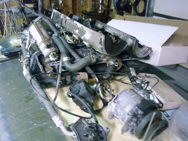

It was also time for remove the non-functioning A/C components.

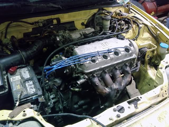

I went back over this evening and he had already prepped the donor head and the stock block. We threw on the head and Intake mani.
