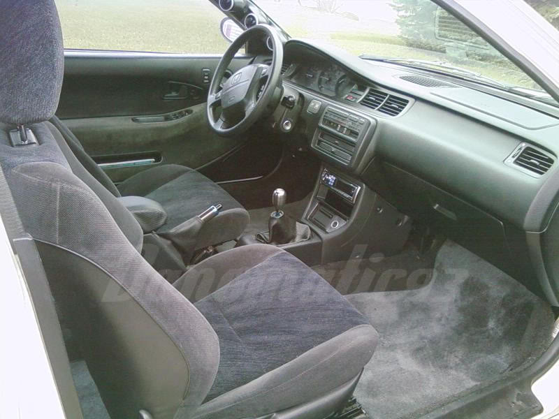

I installed the HOP console in and the Cup holder/Coin tray.

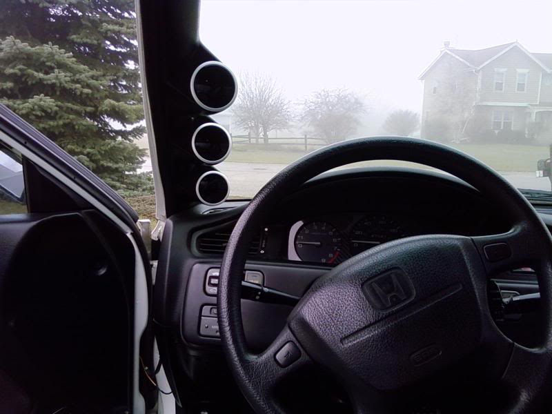

I finally got my diagnostic gauges in (Volts, Oil Pressure, A/F aka Light Show)

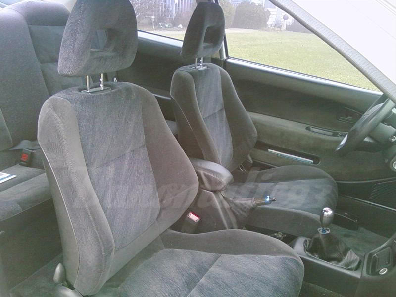

I also picked up a set of seats from a 98 Integra from traitorzxiong. Lumbar Support!!!!

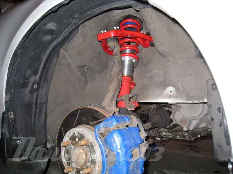

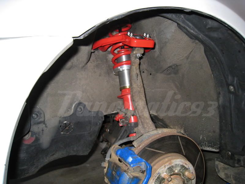

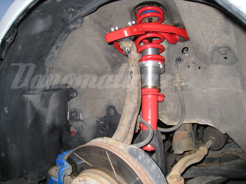

So, today I got around to putting the coilovers, camber kit, and KYB AGX shocks on the front finally.
Also, while I had the wheels off, I screwed on the EK mud guards. That I picked up the the good ol' junk yard last weekend.
I don't have pictures of the whole car since I'm letting the springs settle before I drop her lower. I feel a slight difference over bumps, but I attribute that to the new shocks. I was using the stock Honda shocks with a cheap lowering kit before.

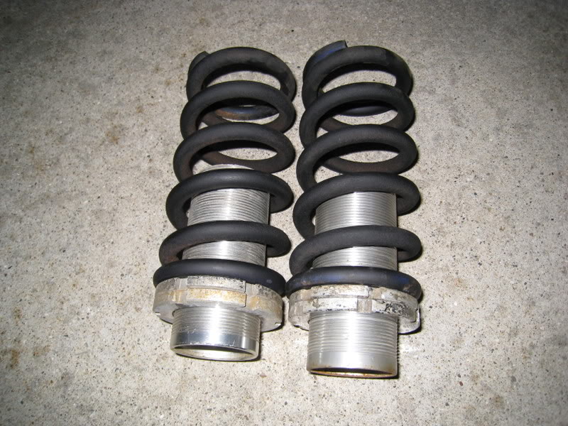

Here are two of the old coilovers (repainted to black, of course)

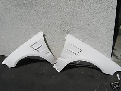

The fenders that I'm fixing up look will look like these (X1 Style):
I'm not going to put them on my car. I just bought them "cheap" because some guy didn't want to do the fiberglass work to fix them. I plan to fix 'em and sell 'em.

Here's an idea for ya:
instead of fixing up the fenders and selling them, how about fixing them up, shaving the vents, and putting them on your car as stock-style fiberglass fenders? They wouldn't dent, and you'd still be saving around 4lbs on the front end.
