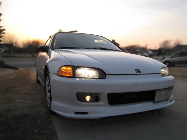

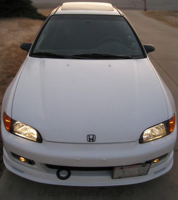

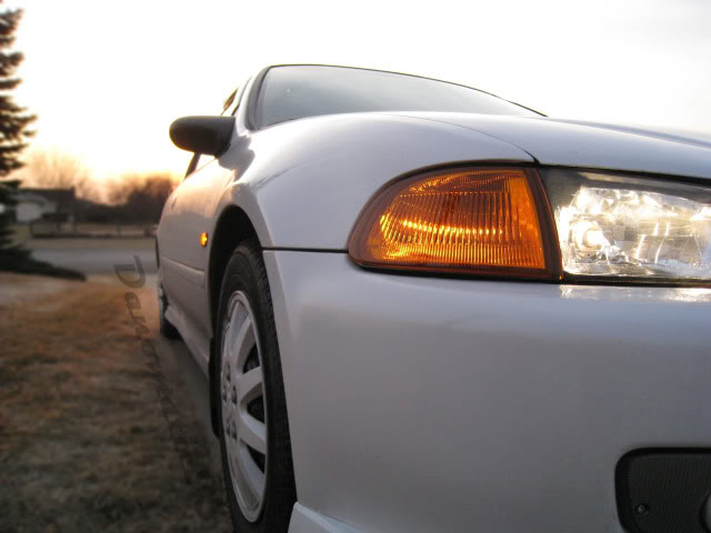

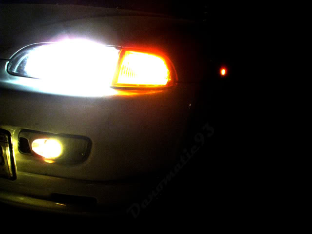

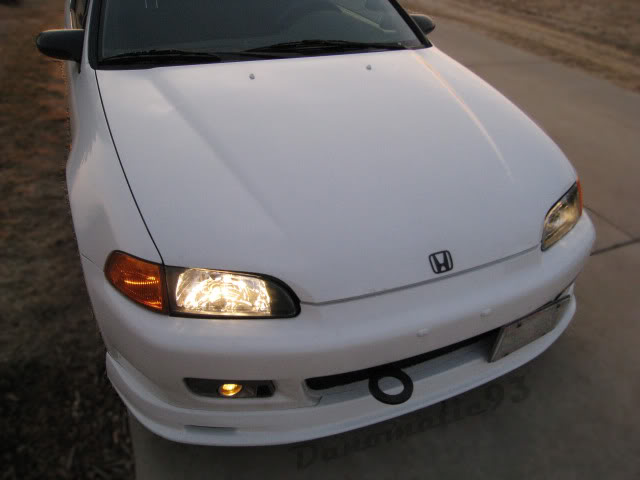

Got the tow hook on, foglights, painted the chicken fence, and finished with the dress up washers (pics of those later, I have to clean the engine bay first)

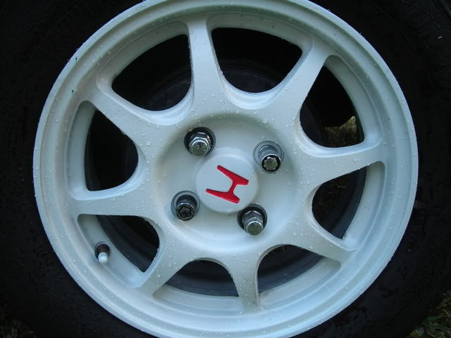

Yeah, I have to get around to that. I'm still pretending that I have a set of HX wheels until the salt is washed off the roads.
Hopefully I'll get my hands on a set and I'll paint 'em like this...
Old Mar 17, 2009 | 08:37 PM
  #168
Nice, me likey. lol
Do you have ABS? I'm pretty sure HX rims don't fit over 10.2" brakes.

Nope, no ABS here, and the 14" HX wheels clear the outer edge of the caliper but I'll have to trim a little off out the caliper bracket otherwise the hub of the wheel rubs. I could also rectify the issue with wheels spacers but then extended lug stud may be advisable. So, I'll just trim the bracket.
