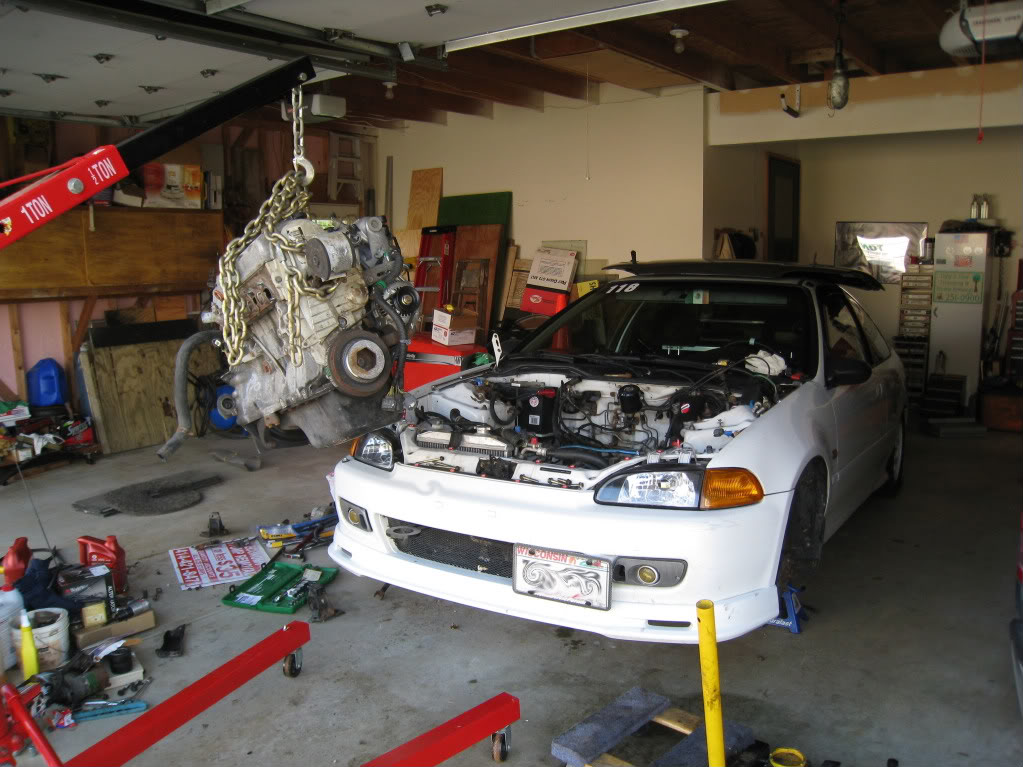

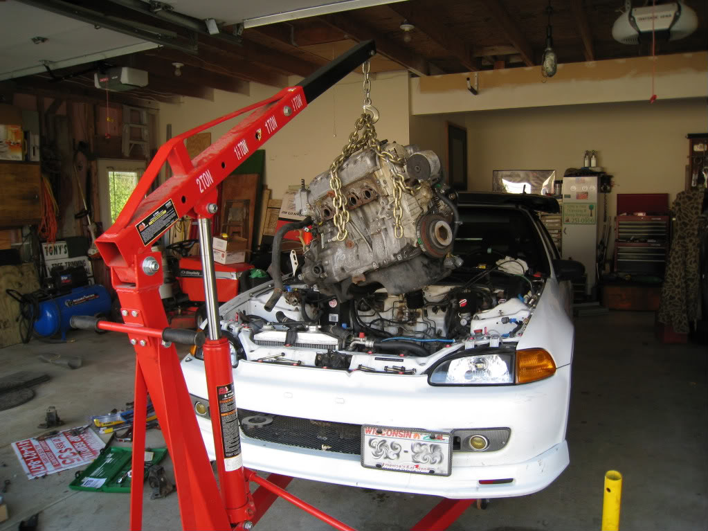

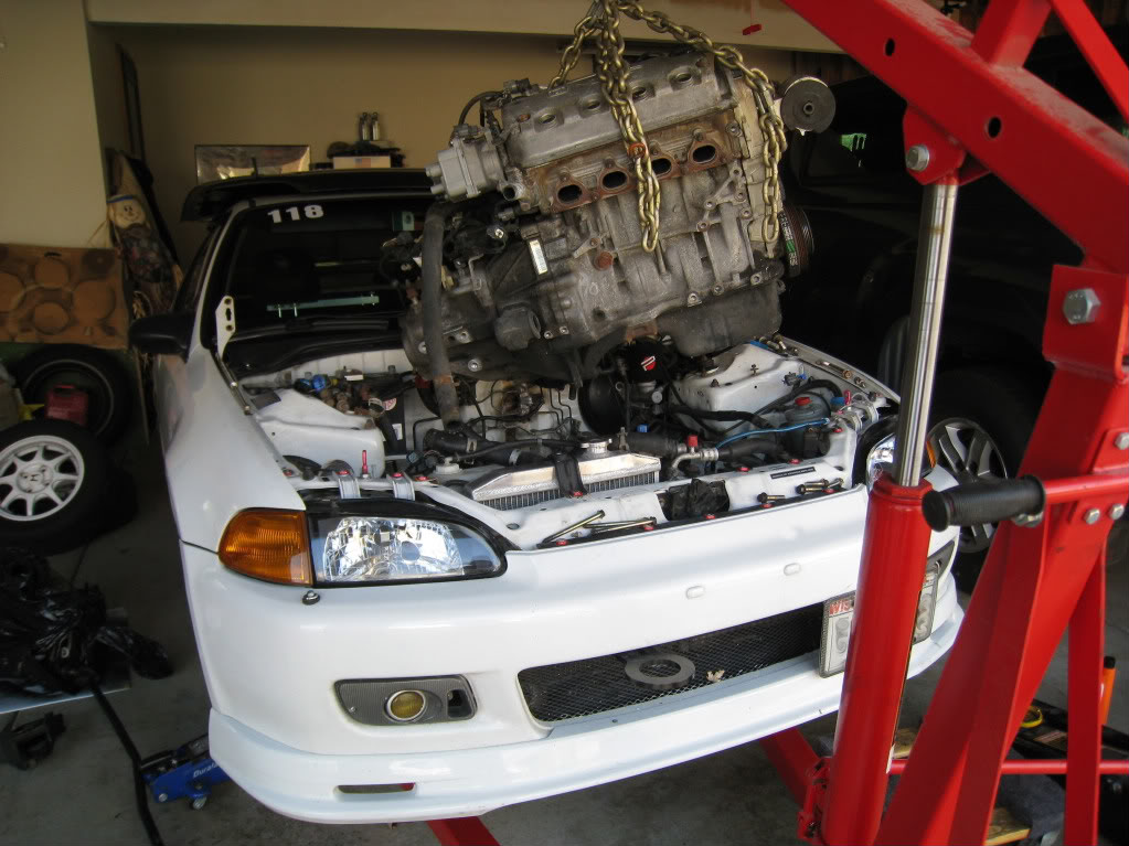

It's been a while but I got the 'new' engine in.
I have 3 things that I know I have to do yet.
1. CEL #6 Coolant temp sensor.
-I'm going to test if it's the sensor or the wiring.
-I'm also hoping that it's the only reason it starts hard as w/o the sensor the pulse width of the fuel injectors will be off and it will run very rich.
2. Bleed the Clutch.
-Somehow fluid disappeared. I hope I didn't cut the line...
3. Swap ECU's back to a stock p28
