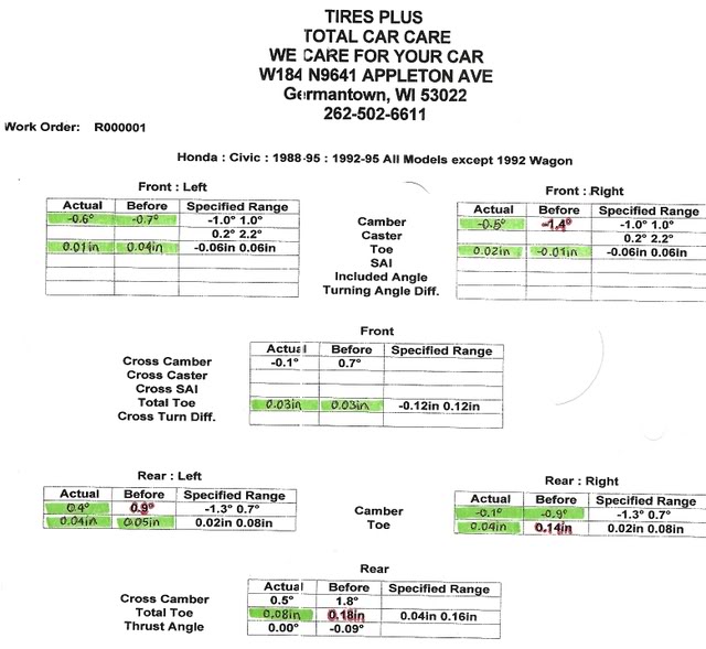

Got the Blox Toe Adjusters installed and got the alignment done too.
Plus, I finished this season's To-Do list!
