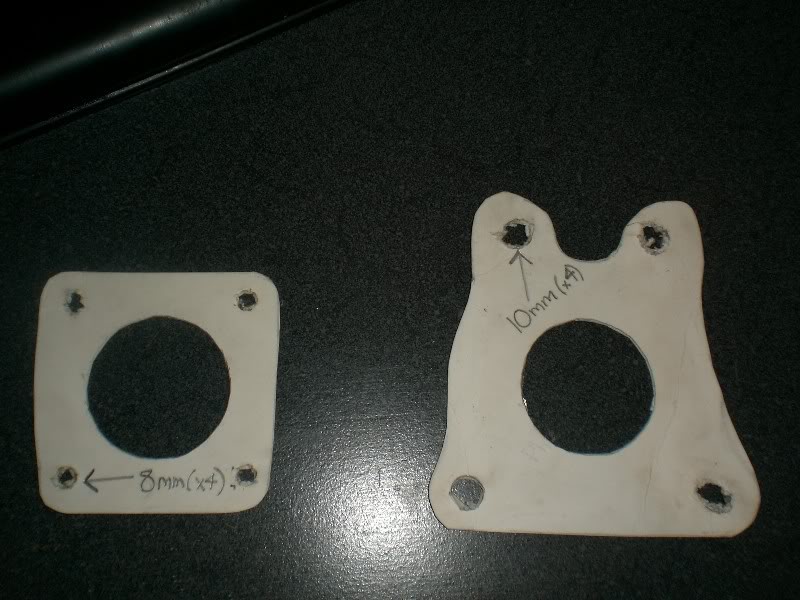

k so Adapter Plate templates are made on on their way to Didder gonna use about an inch or two of2" piping betwen the two plates, should work well, heres a pic of the templates:
i think they turned out alright
oh, and also (thanks to Sov), i unbolted my compressor housing, and (as scared as i was) hit it with a hammer and pivoted it around so the charge piping outlet is facing down, just how it should tightened it back up and we're all set to go. Just need to figure out which coolant line is inlet and hwich is outlet now.....
