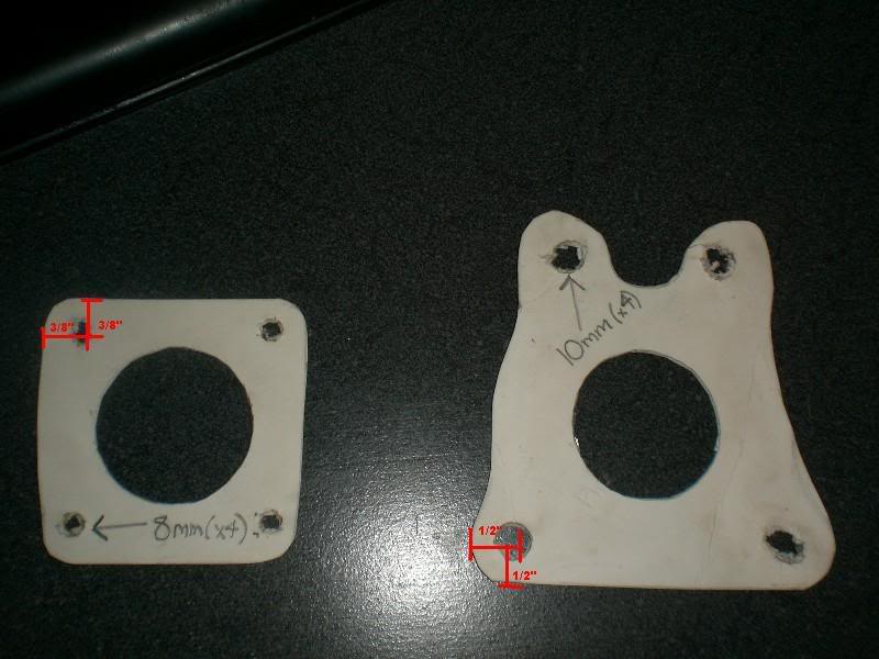

heres i made some measurments on the adapter plate picture, hopefully this helps

you can always make the plate holes a tad smaller and you could finish drilling it in order to ensure a proper fit.

^ yea i was thinking the same thing Didder, if there a bit too small or off a little bit i can drill them out myself
oh, a question: what am i gonna do for gaskets between the adapter plate and turbo/manifold?

you got a drill? drill it yourself lol, i dont wanna screw up the most critical part
wont take you long than 10 minutes to drill it all out so yea, just have fun drilling through 5/16 a/r plate [&:]
that **** is like twice as strong as regular steel, just get one hole drilled, bolt it up, and then find your 3 other holes and mark them and drill them...
repeat on other side, ill ship it out when i get back to work and honestly ill be surprised if it works [:@], the damn pipe is huge, should have used 2" instead of 2 1/4" but owell we will see soon enough wont we

sick, yea i can drill it out, and having it here to go directly off of the flanges will be better. Thanks alot, how much you want for shipping?
