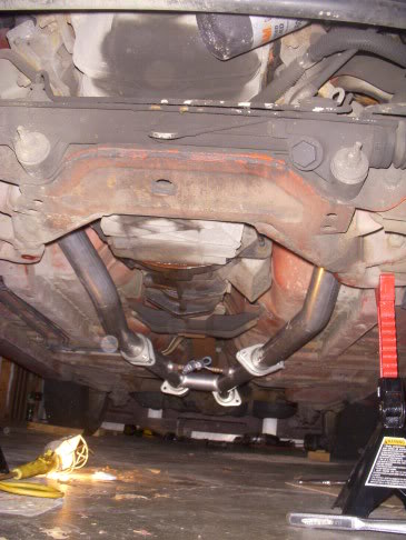

And the sexy new off-road H-pipe (complete with "Off-Road Use Only" plate welded on ):
From the front of the car:

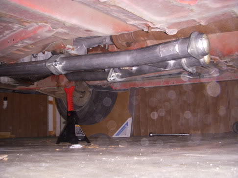

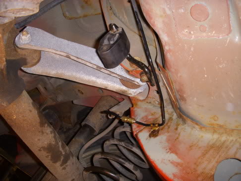

Why spend $30 for a Mustang GT muffler hangar at a dealership when you can make one?:
And why spend money on tailpipe hangars when you can make your own (with no rattling so far )
One of the hangars in place (lol @ my brake line... you can see my fix if you look close):
The new exhaust in place (more pics tomorrow):

2.25" tubing, not one, but four cats, and a sound only grandmas would enjoy
Compared to this:
2.5" mandrel-bent tubing, no cats, and that deep "I'm going to beat the s**t out of you with a baseball bat" sound

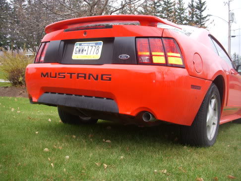

'Nother rear shot:

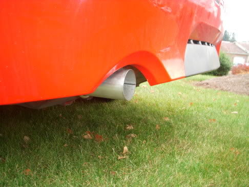

One from the ground:
And none of that ricer "tips hanging an inch past the bumper" s**t here:
