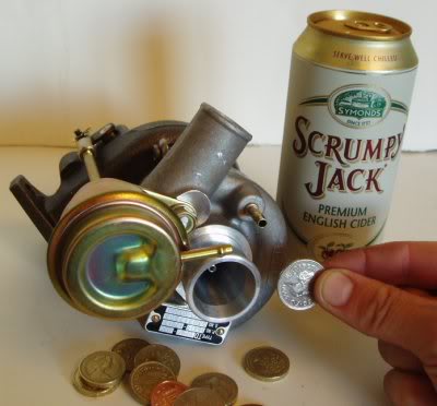

two of these should get the job done
Old Jul 16, 2009 | 04:37 PM
  #540
I'm running twin-turbos. I don't plan on running one turbo for each cylinder (though it'd be awesome). In other words, I'd like something a little bigger than a can of Scrumpy Jack premium english cider
