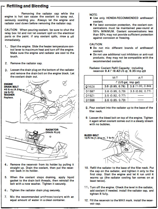

1) Have you tried cleaning the EACV (IACV)? See forum DIY section.
2) You may have air trapped in the cooling system so try bleeding the system. No need to drain the coolant. Just push the heater lever to full heat, top off the radiator and reservoir with coolant, and then bleed the system of air:

No check engine light at all. Like I say, it passed AZ emmissions no problem.
Cooling system has been purged and pressure checked.
