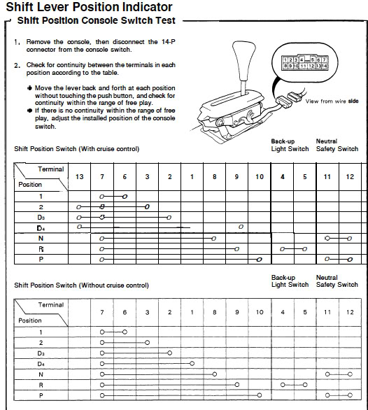

Old Mar 7, 2010 | 06:42 AM
Start by testing the switch.

im sorry i should have specified clearer. im talking about the park reverse etc. lights in the gauge cluster not the shifter itself.
Old Mar 7, 2010 | 08:16 AM
The shifter switch controls the lights in the cluster.

Old Mar 7, 2010 | 08:29 AM
Originally Posted by new_2_civics
so your saying if one of the bulbs is burnt out in the cluster, i change it in the shifter?
No. I am saying that power to the cluster D4 light is controlled by the shifter switch. You need to test the switch and wire between the switch and D4 light before assuming that the D4 light is bad.

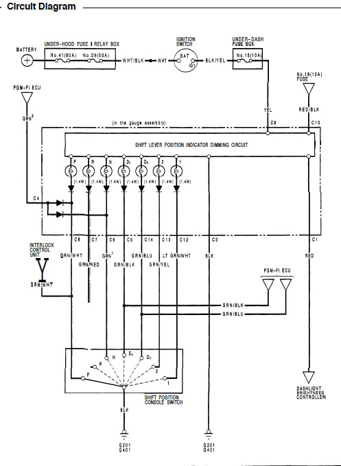

Old Mar 7, 2010 | 08:34 AM
every other light comes on except that one
Irrelevant. I am trying to help you. You need to test the switch.
