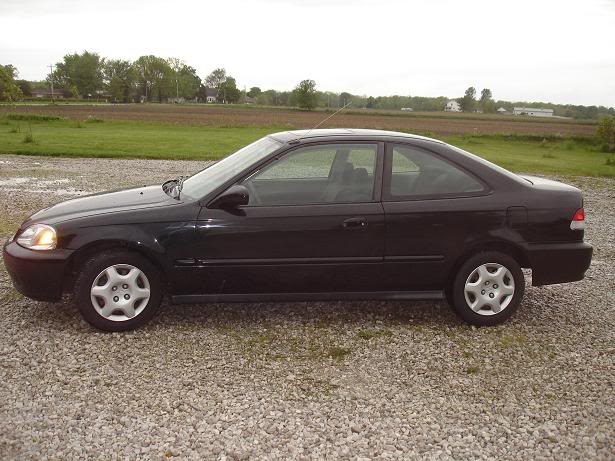

very true.... a good tint job makes a HUGE DIFFERENCE... compare my before and after shots..
AFTER
20% on front side windows and rear window, with 5% on the sunroof, and rear side windows, not sure on the eye brow % tho....

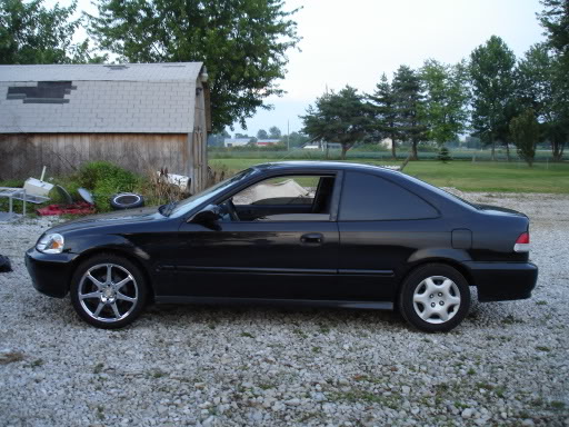

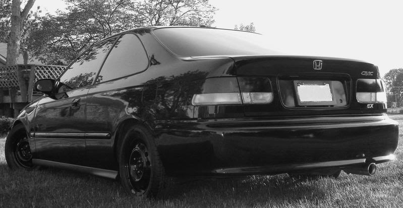

tho remember... black cars i think look best tinted.
but tint and rims makes a HUGE difference
i just love this shot

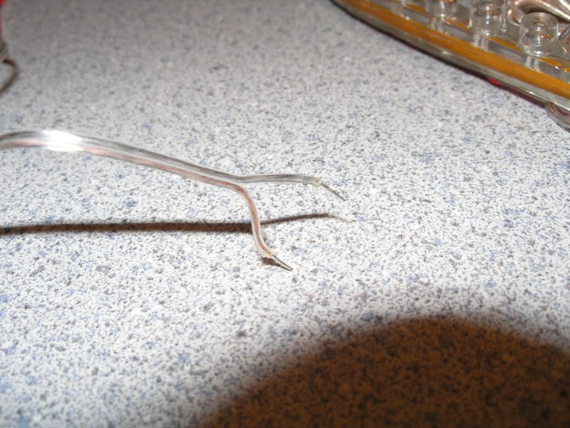

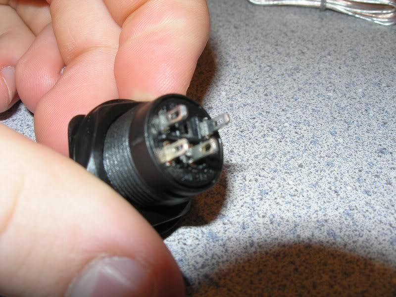

Alright, bought the two 9.5" LED Flexstrips (very bright) and the LED switch. So I looked where I want to attach the strips and I decided to put the switch where the cig. lighter is. So I took out the lighter and taped off all the unattatched wires so now I have a hole to put the switch. Now my question is exactly how to wire. I'm going to put this is very basic terms so it would be appriciated if you possibly could too
On the LED strip there is a wire with a silver color and bronze color. (I'm assuming power and ground) then on the back of the switch there are 4 prongs: (Here is also a little diagram from Oznium.com [Great site BTW] which has some info. which I'm not quite sure what it means ) http://www.oznium.com/paddle-toggle

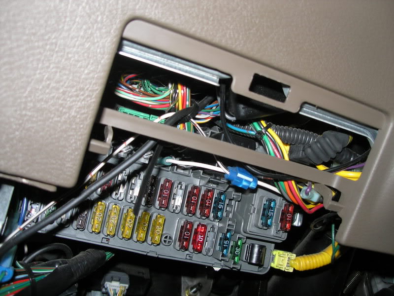

Then there is my fuses:
So if someone could breifly explain where to attatch the bronze & silver wires from each of the LED strips, and how to connect the wires to the switch, and where to get the power supply form, it would be very greatly appreciated!

its exactly what it says on the switch... most likely tap into that white wire thats already pluged into the fuse box or one of those plugs up thier depending on WHEN you want it to have power... im preaty sure in that white wire location is only powered when the ignition is ON.......
and on the flex strip the silver wire is power... and the bronze wire is ground.... preaty simple.....
if ya want the switch to light up then you have to use that resistor between the power output and that one prong..... without the resistor it wont light up which realy isnt necesary..... but DO NOT just put a wire thier! if ya do it will just burn the led out!!!!!
im suprised they didnt give ya a resistor with the switch.... my led rocker switch didnt need that resistor crap....

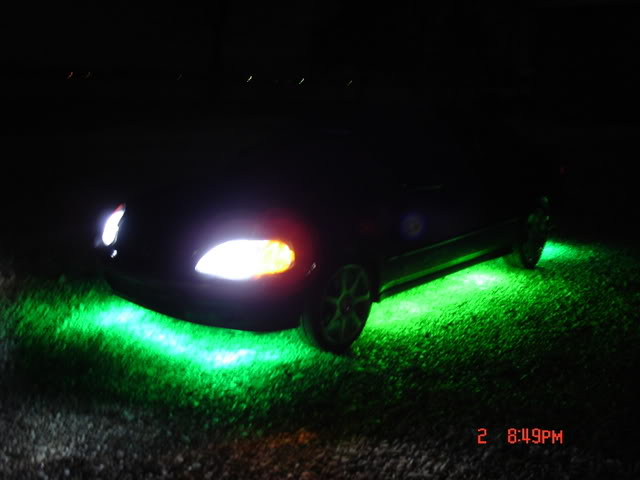

should add... your gonna love the flexleds!!!!! i got them front and back on my civic now... soon to upgrade my sides to the flexstrips also.... my coldcathodes must leak atiny bit and starting to short them out
