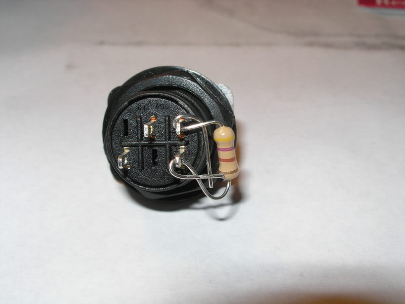

Size:  38.7 KBok just picked up everything i should need, (BTW Radio shack I found to be better than any car store, has everything for the job, at lower prices) but I got the 470 resister and was wondering if there is any special way of putting it on besides just twisting it on there?
and would wiring it to the hot wire on the back of the cig. lighter work just as well as the one by the fuses? i am putting the power switch in the place of the cig lighter and I know there a quite a few wires in that little center console so would you think one could be used from there?
